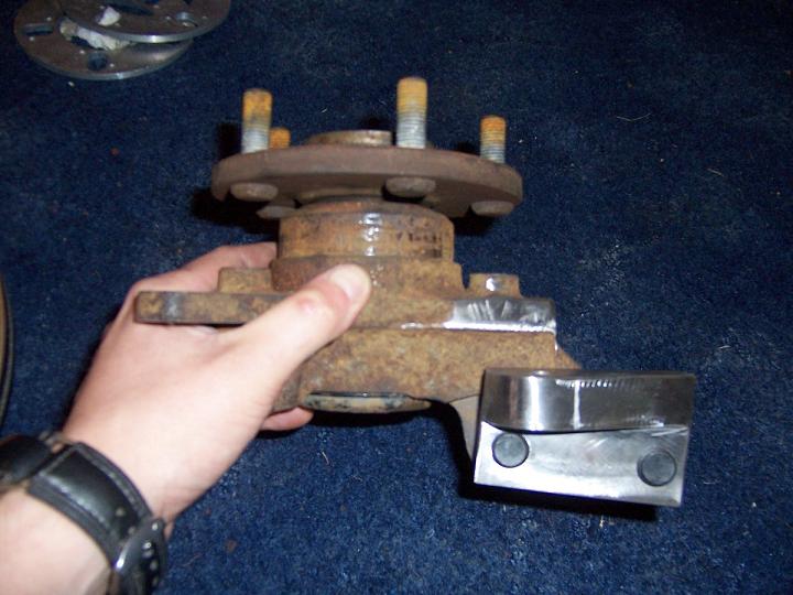

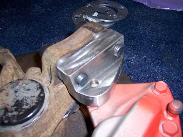

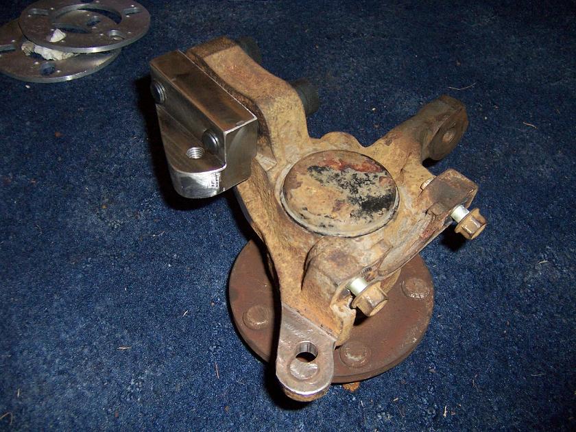

You'll need to make contact with some kind of machine shop somewhere who can CNC you the brackets to your/an enginers design (or an existing design if someone's done this before). You will want to end up with something like this, having accurately measured the mounting points on the MR2 hub and the brake calipers, as well as the finished position of the caliper so that it sits squarely on the disc in all 3 dimensions:
[Image: 138.jpg]
[Image: rearKit.jpg]
Basically, like most things with modifying cars, if someone hasn't done it before then you will have to take the plunge and figure it out yourself, which takes time and a bit of trial-and-error. I know a chap who did this to fit Porsche 996 front brakes to an MR2 and it was a lot of agro and took him 2 or 3 bracket designs to get it spot on. It's doubly difficult if the calipers aren't radial mount.
PS I think you probably want an RX8 front disc on the rear, rather than the Mazda 323 one. You need to be careful about upgrading the rear calipers though - the MR2 has the handbrake mechanism inside the caliper and most cars don't. If you replace the rear caliper you will either need to get a second handbrake-only caliper fitted (AP Racing make one) or just space the existing caliper out on a bigger disc like the RX8 one, which is actually what that kit I've posted photos of does.
Edit: Here are some shots of a custom one-off bracket for fitting ST205 / Supra brakes to the SW20 hub. As you can see, some complicated angles involved, but it has been done (for the fronts anyway).
[Image: garage.php?mode=view_gallery_item&type=g...ge_id=3343]
[Image: garage.php?mode=view_gallery_item&type=g...ge_id=3344]
[Image: garage.php?mode=view_gallery_item&type=g...ge_id=3357]
